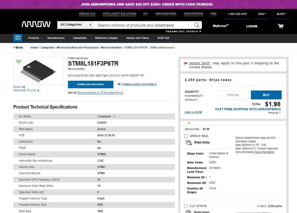

The cost for a redesign of existing products using STM8L, on other architectures, is not insignificant also because it adds up to a standstill in production.I enclose one example of a request for a sample and the indication of delivery times are a tease.
Arrow/Verical show me 2000+ on-hand of STM8L151F3P6TR
