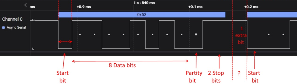

I am analyzing the UART data frame of an outsourced device that uses the STM8S105 MCU. The data frame specification is:
* 1 start bit,
* 8 data bits,
* 1 parity bit,
* 2 stop bits.
Therefore I expect a data frame as in the below Figure 115 from the STM8 reference manual RM0016. However, both the logic analyzer and oscilloscope show an extra bit after the 2 stop bits. Then the next data frame begins. This is illustrated in the second figure below.
Question: what feature creates the extra bit? This is unexpected.
Is it possibly related to the break character feature?

Extra intersymbol gaps should not break async comms, and may be the result of not responding quickly to a TC interrupt, or not using TXE to tightly pack output stream.
Could be a 9-bit mode or parity..
2023-04-27 3:19 AM
As the extra bit have level '1', so is the same as have 3 stop bits, And so no problem with communication.
How did you detect this extra bit?

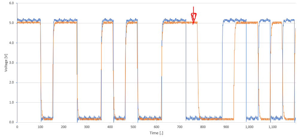

Hello @Arsénio Almeida, thank you for your response. I found the extra but while troubleshooting a malfunctioning UART communication link. The extra bit is easy to see in the below oscilloscope screenshot when comparing it with my own UART comm.
