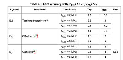

Whats the typical error from ds for this adc ?
You have 630 +/- 4 digits , = 0,6% . What can you expect from ds values ?
+/- 4 digits max. - so your adc is according to ds .
Did you measure the noise at the pin? (Maybe the ADC just showing the real noise there...)
