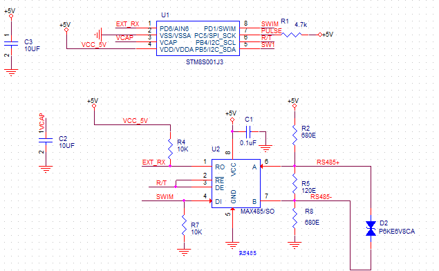

I am having a communication problem with MAX485 ic. I am trying to change Ic receiving mode to transmit mode by using 'PB4' pin and i am using UART1 , SWIM pin as a Transmitter. in some controllers i am unable control pin in the middle working. I am giving both IC's supply is 5V.

The presentation here is weak.
Show the HW side connectivity of the parts and paths involved.
Show the SW side implementation, initialization and logic of what's being done.

Thanks for the reply, please find the below connections between controller and 485 ic
please find below configurations and operations
