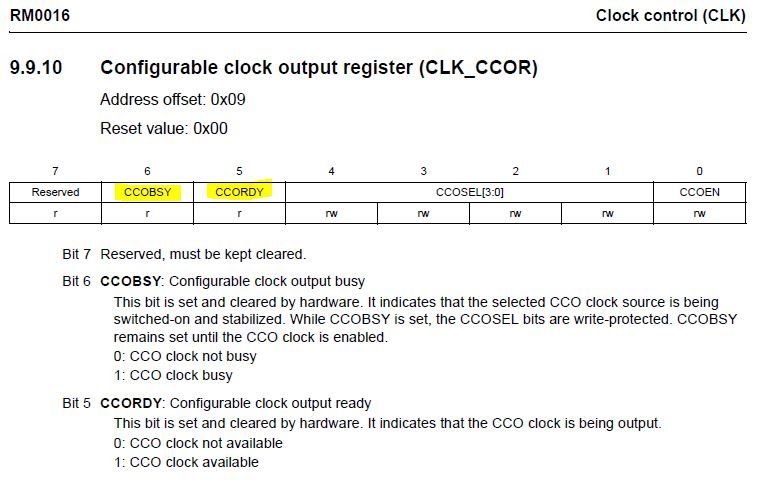

Well, I think I found the problem in stm8s_clk.h.
In RM0016 you can see that CCOBSY and CCORDY are in the upper nibble of CLK_CCOR
I commented out the offending lines in stm8s_clk.h and replaced them with what I think they should be.
typedef enum {
CLK_FLAG_LSIRDY = (uint16_t)0x0110, /*!< Low speed internal oscillator ready Flag */
CLK_FLAG_HSIRDY = (uint16_t)0x0102, /*!< High speed internal oscillator ready Flag */
CLK_FLAG_HSERDY = (uint16_t)0x0202, /*!< High speed external oscillator ready Flag */
CLK_FLAG_SWIF = (uint16_t)0x0308, /*!< Clock switch interrupt Flag */
CLK_FLAG_SWBSY = (uint16_t)0x0301, /*!< Switch busy Flag */
CLK_FLAG_CSSD = (uint16_t)0x0408, /*!< Clock security system detection Flag */
CLK_FLAG_AUX = (uint16_t)0x0402, /*!< Auxiliary oscillator connected to master clock */
//CLK_FLAG_CCOBSY = (uint16_t)0x0504, /*!< Configurable clock output busy */
//CLK_FLAG_CCORDY = (uint16_t)0x0502 /*!< Configurable clock output ready */
CLK_FLAG_CCOBSY = (uint16_t)0x0540, /*!< Configurable clock output busy */
CLK_FLAG_CCORDY = (uint16_t)0x0520 /*!< Configurable clock output ready */
}CLK_Flag_TypeDef;And now all options for CCO on my STM8S103F3 work as I expect them to.
EDIT: STM8S103K3 (LQFP32)
