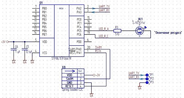

Situation:
Chip STM8L151F3U6.
Circuit = MCU + LED (work time counter)
After manual assembly, we have 80% of the output of defective products.
Current consumption in reset from 0.1 mA to 8 mA (from sample to sample).
Power supply voltage - 3.3 V.
Dropped causes the release of low-quality product:
1. Wrong thermoprofile soldering. Not applicable -large experience of
workers, high-quality equipment.2. ESD damage. Not applicable - the company manages and controls the
media ESD. Working in accordance with ISO 13485.3.Fake component. It is unlikely - the purchase by www.digikey.com
At the moment, there were two hypotheses: improper storage /packaging supplier or fake.Question:
What level of sensitivity to moisture in the component. According to your
response resources are not found. Documentation ECOPACK also does notanswer this question.With all respect, Andrey.
