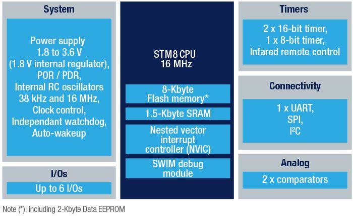

STM8L001J3 belongs to
STM8L Value line of ultra-low-power microcontrollers. It
offers the best price-to-performance ratio for cost-sensitive applications. With a similar core performance and peripheral set as the STM8L151/152 line, Value line has been optimized in terms of features and configurations to reach a budget price.
Some of important features of STM8L001J3:
  • Core and system
    • 2 internal clock sources (HSI 16MHz, LSI 38kHz)
    • Suply voltage range: from 1.8V to 3.6V
    • 6 I/Os
  • Timing peripherals
    • 8- and 16-bit general purpose timers
    • Auto-wakeup unit
    • Watchdog
  • Memories
    • 8k Flash
    • 1.5k RAM
    • 2k EEPROM
  • Conenctivity and debug
    • UART
    • SPI
    • I2C
    • Single Wire Interface Module (SWIM)
  • Analog
    • 2 comparators

That's good news. Judging from the diagram it looks like a new Low-Density device with 50% more RAM.

Thank you for your interest in STM8L001J3. This new device was cerated based on existing one - STM8L101F3. Main difference is of course new, 8-pin package.

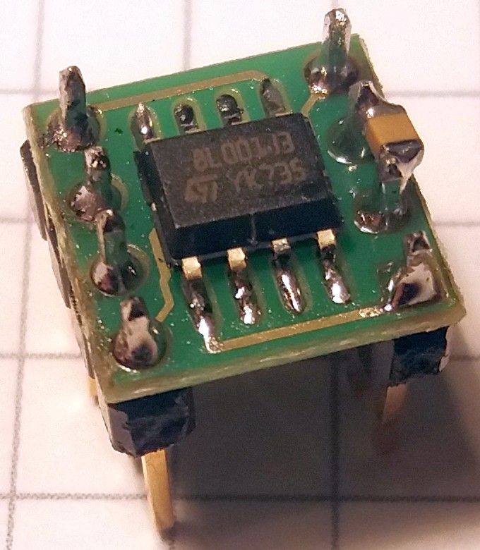

Looks like a very nice little unit that could be quite useful. However Arrow and Mouser both still have it with a MOQ of 4000 and ST themselves want an order for 10000. The others I have tried have not even added it to their lists yet. It is very early days so I can only hope that will change and I presume that the little board pictured above provides the pinouts for the SWIM interface to my ST-LINK V2.

Hello David,
If you would like to evaluate STM8L001J3, please send me a private message with your postal address. I can send you one board with this MCU. In order to program/debug the MCU, you would need to connect SWIM, GND and VDD signals to ST-LINK V2 on your own, but it is very easy to do, as no external components are needed.

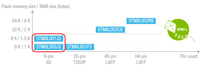

Dears,
I would like to update this thread by sharing with you information about another 8-pin STM8L MCU. ST recently introduced
http://www.st.com/content/st_com/en/products/microcontrollers/stm8-8-bit-mcus/stm8l-series/stm8l-value-line/stm8l050j3.html
. As a resultnow there are two8-pin STM8L devices: 0690X00000609QDQAY.png
The complete portfolio of 8-pin STM8 MCUs consists of three devices: STM8L001J3, STM8L050J3 and STM8S001J3.

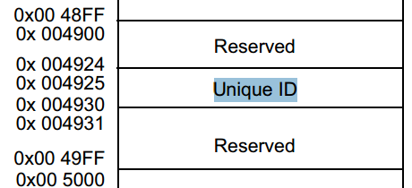

Hello Szymon,
In the datasheet for
STM8L001J3, under section '5 Memory and register map / Figure 3. Memory MAP', there is a memory location named as 'Unique ID' but there is no more information about it neither in datasheet, nor in reference manual.
1.Is there any unique ID for die specific?
2. If so, is it readable by application?
Do you have any more details about this ID(bit size, etc...)
Thanks.

2.
Unique ID is stored in memory, so application can read it by refering to proper memory address. Unique IDstarts at 0x4925 and ends at 0x4930 as stated in MCU's datasheet:
This means that unique ID consists of 12 bytes (96 bits).

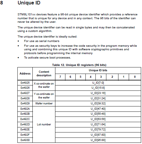

Hello Szymon,
Thank you for the update.
There is a ''unique ID'' sectionin the datasheet of STM8L101x1 -
STM8L101x2 -STM8L101x3 devices explaining the uniqueness. I think it also works for
STM8L001J3 devices.
I will give it a try after i get the device.
