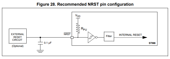

Hi
Tom_Mathew.Allan
,I would strongly recommend to keep solution no 3 concerning NRST line (only 100nF capacitor to GND).

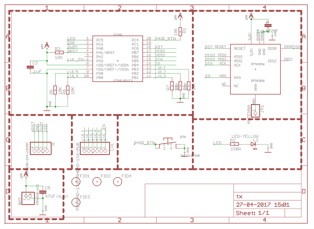

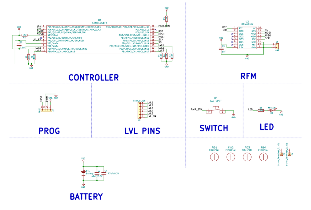

,Thank you for your reply.This isthe schematic for the transmitter which employees a STM8L micro controller for its operation.
The is the full schematic design.
In the design of the transmitter, there is no functional change. The board size has been changed to fit into a new enclosure,whereby the layout has been changed.
Project 1
This is the old schematic (the working and deployed version):
This is the new schematic (version which has the issue):
According to the datasheet we need not put a pull up resistor for the NRST pin. Thoughthe former
design
worked flawlessly with the pull up on NRST, the latter didn't.To rule out this mistake, we tweaked the design:
These were the observation that we had.
