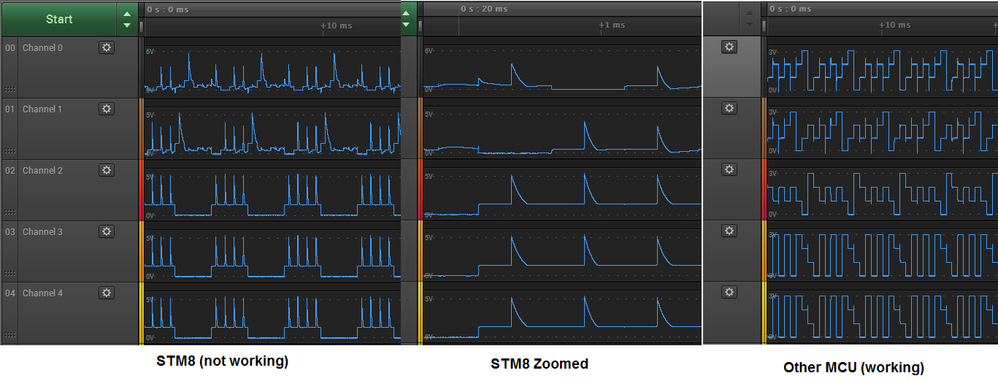

I have a custom LCD that I am trying to drive with theSTM8L052C6. I have tested the LCD with 2 other MCUs and it works fine. However, when I try to drive it with the STM8, it is very dim and almost not visible. I probed the pins on another MCU that works and compared it with the STM8 trying to drive it.
This image shows the STM8 vs a working MCU. For some reason, the STM8 will drive to the correct voltage briefly then will drop. I'm not sure what could be causing this. I have tried to change parameters in almost every LCD related register.
Any ideas would be greatly appreciated. I've been stuck on this for quite some time.

Thanks for the response. I tried setting that bit again just to be sure. For some reason, when that bit it set, the LCD is nearly invisible. It might be completely off. I don't have my scope with me to check, but it seems to make the problem worse. Any other ideas as to what could cause this?

Check VLCD
-NC
2017-02-15 2:30 AM
Thank you!
The problem was that I didn't have a capacitor placed on the VLCD pin. This was frustrating because it seemed like things would sometimes work, but if I slowed down the clock or even enabled LCD_CR2.HD the display would appear off. With the capacitor in place, it works fine.
