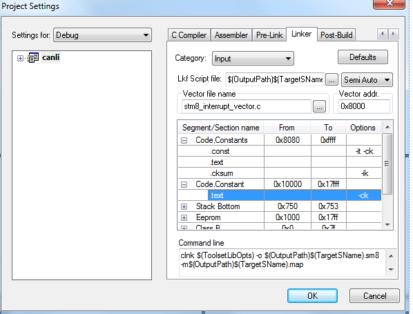

i have done another work
. Depends on these work. May you result anything?
We had one segmet(Code and constant) which locate 0x8080 to 0x17fff.
_block_checksum161() return CRC_ERROR.
Now we have 2 segment. First segment  for constant and code where locate 0x8080 to 0xffff, seconds segment is for .text where locate 0x10000 to 0x17ffff.
block_checksum161() return OK
Unfortunately we can not use first segment for .text.  .text which locate  0x8080 to 0xffff is not used.
?f .text of secons is overflow, it do not use .text of first segment. ?t gives overflow error.
