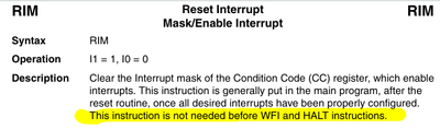

2026-05-14 8:19 AM
That is fascinating. PM0044 states RIM is not needed when using WFI:
I must be misunderstanding... in any event later today I'll bring the RIM instruction in and test.
