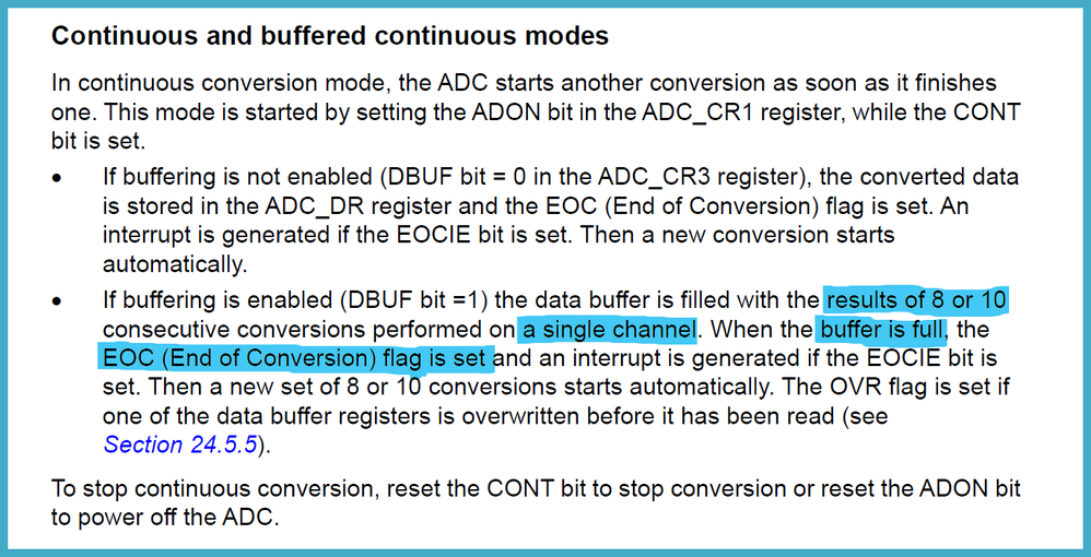

As the reference manual describes, in this mode then 8 or 10 consecutive conversions (depending on the model) are carried out on a single channel. The results are stored in ADC buffer registers DB0R..DB9R then the End Of Conversion flag (EOC) is set, which can generate an interrupt. So it's somehow an efficient way to convert 10 values without stalling the CPU or firing many interrupts.

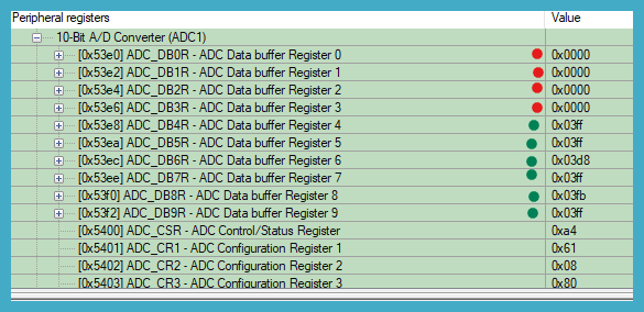

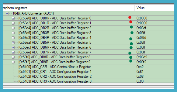

However, it seems that a conversion on a specific channel only fills the buffer registers with numbers greater than the chosen channel. For example, if we try to convert from channel 4, buffer registers 4..9 (6 buffers) get filled and the EOC fires. Buffers 0..3 will have a value of 0. Instead, if we choose channel 2, buffers 2..9 get filled.
I've connected the selected channel to VCC. I'm pretty sure that the conversion takes place correctly and all the buffers have the same value. Consecutive conversions don't also fill the remaining registers.
Converting channel 4, after firing EOC interrupt:
Converting channel 2, after firing EOC interrupt:
