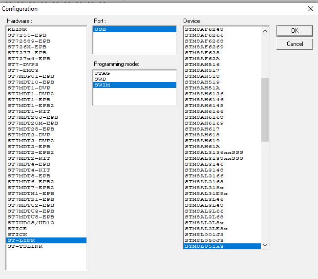

When I use STVD or STVP to program the code on the chip, when pressing start I get the following:
Cannot communicate with the device, check the SWIM connection...
