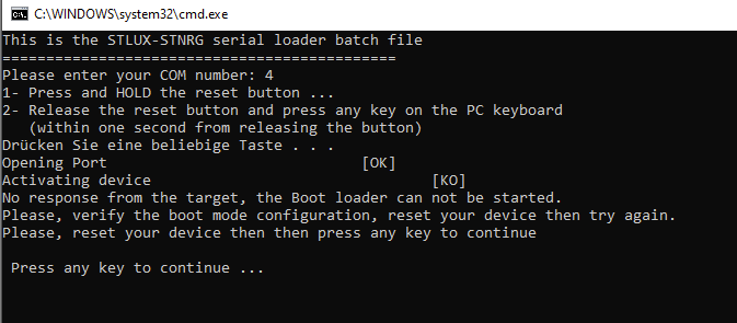

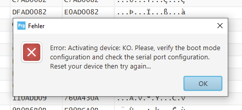

So i tried to load the lasted FW with the console tool, but this also does not work - i tried several times
i tried to load the bin file with ST-Link and SWIM Cable, also i tried like suggested here:
https://community.st.com/s/question/0D53W00000zmw4PSAQ/which-software-can-i-use-the-out-extension
But no success: is there anything else i could try?
