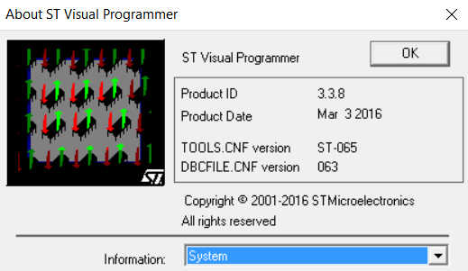

The tool version is:

I tested it with STVP 3.3.9 and have the same problem. I think If the full memory size is 155 kB then the hex file is not created properly and i should check more IAR workbench.
This is displayed in STVP:
and the hex file shows:
I think that is the problem that the STVP dont know the range, and the hexfile ends with:
and this is the last address that STVP shows as warning. I guess the problem is not STVP more IAR Workbench that creates the file.
