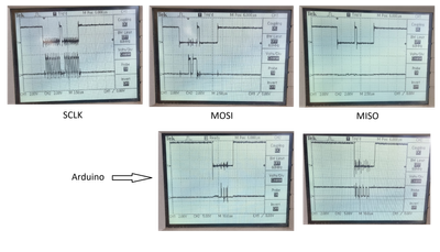

From the scope, top row is from the STM32WB55, bottom row from the Arduino.
Channel 1 - top trace is the CS line. I couldn't get a reading of the clock & the CS line one the Arduino, as soon as I probed SCLK then the chip errored out and just returned 0s & the clock & CS traces interfered with each other..
The STM MISO line is always 0 no matter what command I send, so no ID, no axis data, always 0.
I notice the CS line has that blip which I assume is the gap between bytes being sent?
SCLK is bang on 4MHz

@NicRoberts wrote:I notice the CS line has that blip which I assume is the gap between bytes being sent?
Looks like it.

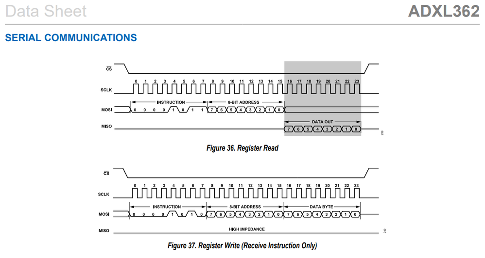

That'll be (at least one reason) why it's not working - CS should stay low for the entire transaction:
