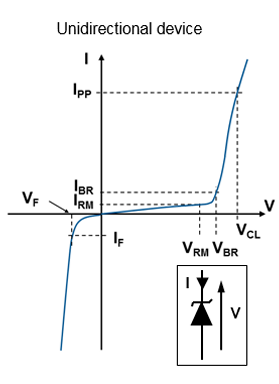

According to datasheet of SMBJxxA series, may i know do we have any option having voltage is 60V? Part number SMBJ60A is not valid in Datasheet.

Options are listed in the datasheet. Probably SMBJ58A is suitable. The voltage refers to the end of the linear-ish region (V_RM). Diode doesn't turn on until a bit after that.
