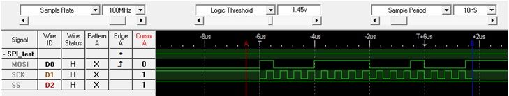

Hi all,
Is there anyone who can give me some advice about the STM8S SPI? I tried to setup STM8S105 as the SPI master mode with the hardware slave select management mode which is transmit only mode. Here my source code is below: /*High speed internal clock prescaler: 1, Fmaster = 16MHz */ CLK_HSIPrescalerConfig(CLK_PRESCALER_HSIDIV1); CLK_PeripheralClockConfig(CLK_PERIPHERAL_SPI, ENABLE); /* Initialize SPI */ SPI_DeInit(); /* Initialize SPI in Master mode */ SPI_Init(SPI_FIRSTBIT_MSB, SPI_BAUDRATEPRESCALER_8, SPI_MODE_MASTER, SPI_CLOCKPOLARITY_HIGH, SPI_CLOCKPHASE_2EDGE, SPI_DATADIRECTION_1LINE_TX, SPI_NSS_HARD, 0x07); /*Enable the SPI */ SPI_Cmd(ENABLE); /*Send data form a master to a slave */ while (SPI_GetFlagStatus(SPI_FLAG_TXE)== RESET); SPI->DR = Data; When I send data NSS signal is not going down but staying on high as below a picture.We’re moving the ST Community to a new platform to give you a better and more reliable community experience.
