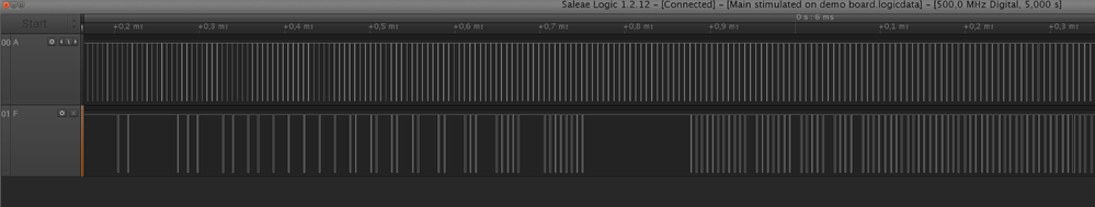

In the first test case the input pin was read in a main loop and copied to an another. No ISR was enabled.
while (1) {
TRIGGER = PB_IDR_bits.IDR0;
The code reliably detects pulses longer than 890ns, but also capable of reading port states in much shorter impulses.

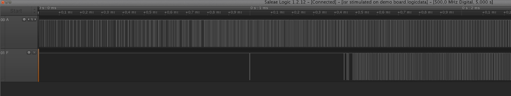

But if I perform the same task with an empty while(1) {} main loop with the following ISR code I got slightly different results. The interrupts are configured to trigger interrupts on both edges (EXTI_CR1 = 0b00001100; // using external ISR on PORTB both edges).
* @brief External Interrupt PORTB Interrupt routine
* @param None
* @retval None
INTERRUPT_HANDLER(EXTI_PORTB_IRQHandler, 4)
I get the following:
The first detected pulse is 950ns wide and it detects reliable pulses longer than 1.350 us.
