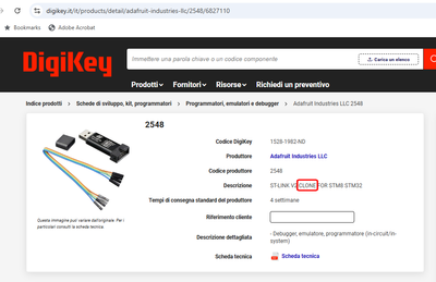

@spider87 wrote:I am trying to debug it with the ST-LINK V2 programmer (https://www.digikey.it/it/products/detail/adafruit-industries-llc/2548/6827110). Gian
That's definitely not a genuine ST-Link - see:

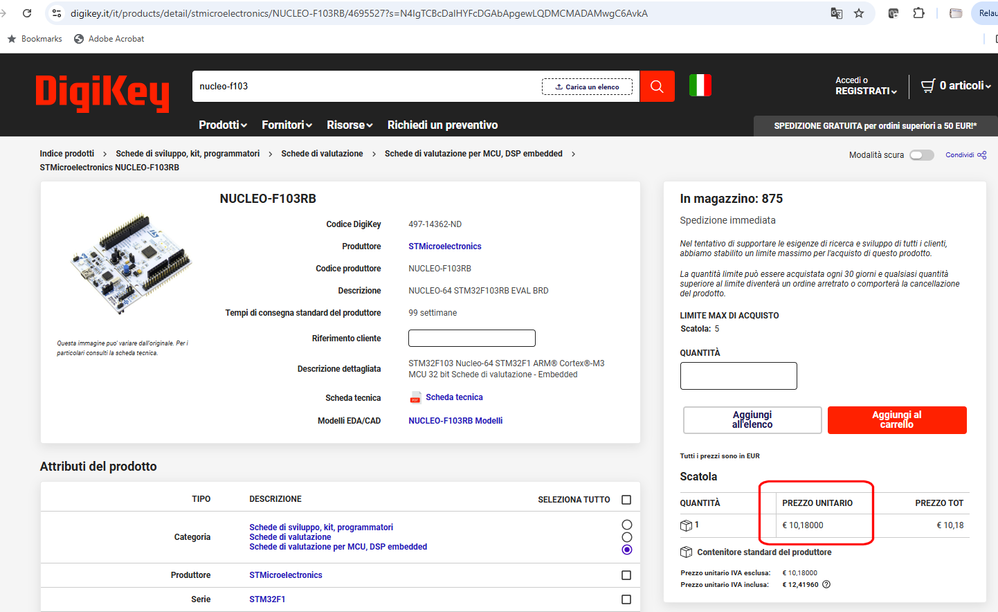

For best results, get a Nucleo board - which gives a genuine STM32, includes a genuine ST-Link, and is fully supported by ST.
PS:
The Nucleo is actually cheaper than just that Clone ST-Link at Digikey!

2025-04-23 1:50 AM
@Andrew Neil wrote:That's definitely not a genuine ST-Link
It even says so on the Digikey listing!
