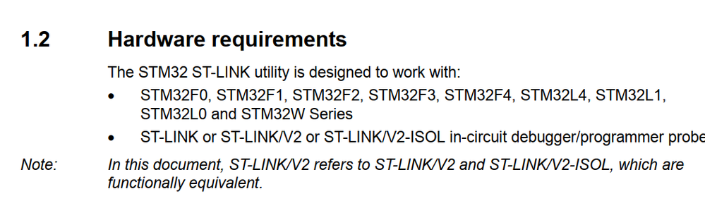

2019-08-29 8:19 PM
I got the ST-LINK/V2 in circuit debugger and connect the STM8 in SWIM interface and used the STM32 LINK Utility tool to program. But it is not working and giving me the error "can not connect to the target". What I do here? Is STM32 Link utility is for only STM32 families?
2019-08-29 9:16 PM
I found that STM32 Link utility only works with the STM32 families from the user guide.
So for the STM8, required STVP tool. Is it?
