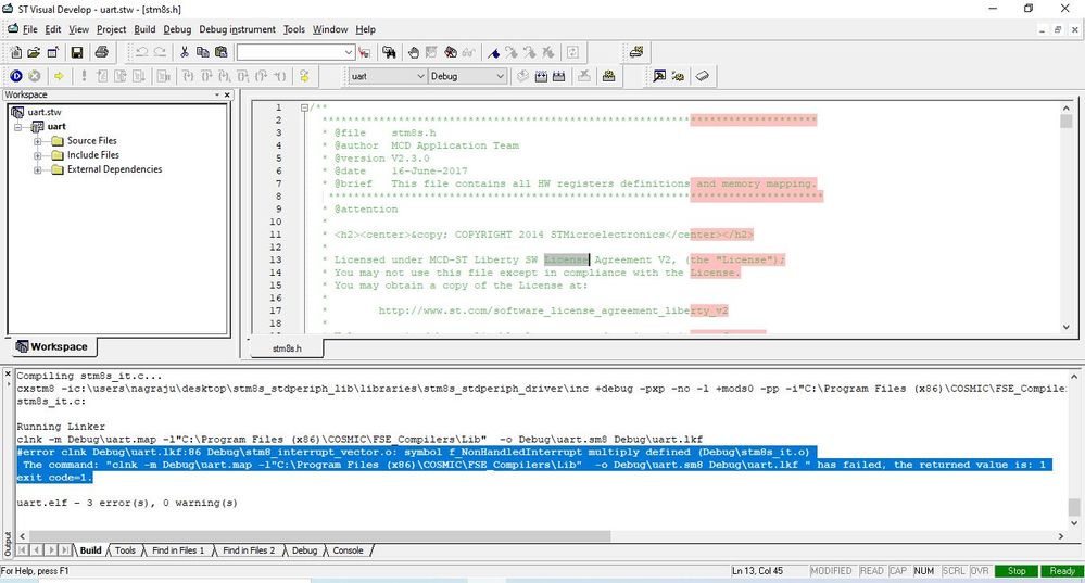

actually iam new these STM8 microcontrollers and i have been trying the basic peripherals, in that process i have started with UART and i tried to compile all the Standard SPL library files and having this error please help me
-PFA-
Thanks
Raj

Hello ,
I go the same error. It is resolved by commenting the non handle interrupt in stm8_interrupt_vector.c file .
just comment the non handle interrupt written in stm8_interrupt_vector.c file .
You are getting this error because non handle interrupt is also defined in stm8_it.c /.h file
I am sending you the screenshot too.
please find the attachment.
please answer me if my solution resolved your problem.
thanks
Deoyani

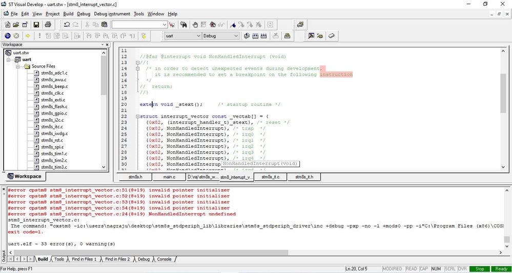

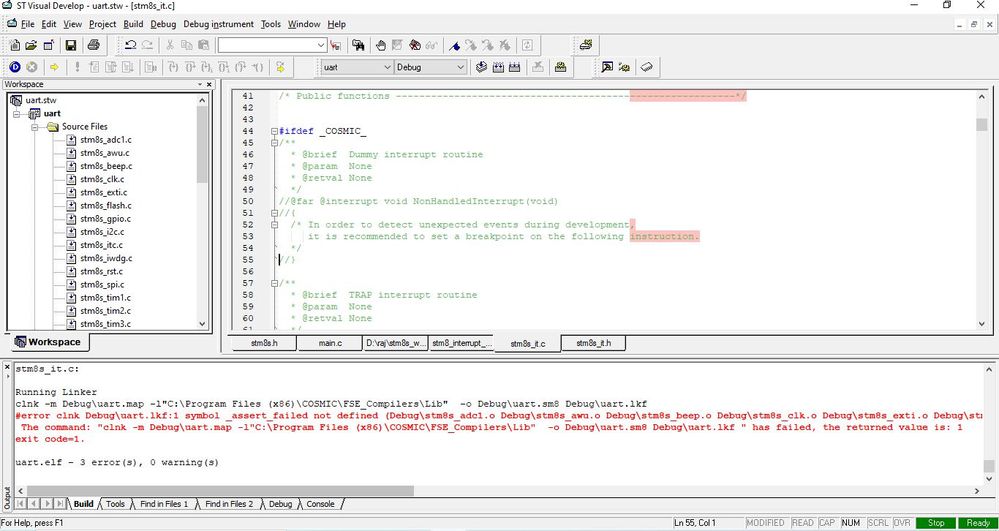

Hi DJosh,
Thank you very much for your support,
i have tried to comment "NonHandledInterrupt" from stm8_interrupt_vector.c file and iam getting this error(PFA), after that i have even tried uncommenting here and commenting the same function from stm8_it.c & stm8_it.h(at same time) then also iam getting the errors(PFA)
please help me
Best Regards,
Raj.
