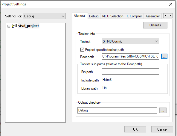

2021-01-30 8:39 AM
2021-01-30 9:09 AM
No need to set any path here in STVD Options Tab.
Check if Cosmic STM8 FSE is correctly installed in C:\Program Files(x86)\COSMIC in your computer and the path is need in Workspace Project Settings -> General Toolset Info Tab
Best regards
