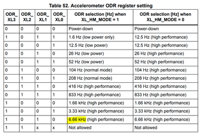

2023-10-16 10:57 PM
Hello Team,
I am trying to read accelerometer data by setting frequency from 0x10 to 0xA0, when frequency reaches 0x80(1.66KHz) at this condition i2c write is failing and there will be a halt. I am able to read data at frequency=0x80(1.66KHz) when Low Pass Filter(LPF2_XL_EN) is disabled with halt at 0x90.
Without performing the above scenario If I try to set frequency=0x90/0xA0 only then the axes values are read but only with 376reads/sec.
Why there is halt at higher frequency and also I wanted to read data >400 reads/sec, Do you have any information regarding this?

Hi @TDK ,
No the function doesn't return an error code. It will remain in loop. It is hanging before the pclose(fp) whenever frequency reaches to high i.e after 0x80 (1.66KHz). Please find the attached screenshot.
