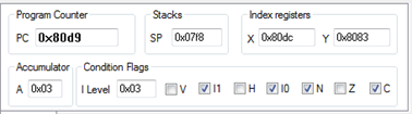

}In this case, when p_address points to 0x80dc, this is what we can observe in the dissasembly and the core registers:
1) This set the address we want to read in X
0x80d7 <main+9> 0x1E04 LDW X,(0x04,SP)
2) This reads the value in the address point by X :
0x80d9 <main+11> 0xF6 LD A,(X)

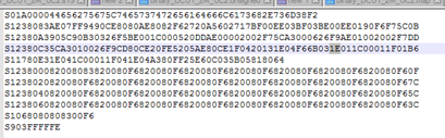

But the data stored in the accumulator (0x8b) is wrong according to the memory view:
Or the Srecord:
On the main application, all the data that was read incorrectly was where a LD or LDW instruction was placed. Also in this example, as 0x80dc has this disassembly:

I haven't tried, I had a bit of pressure to find a solution so I decided to forget about the algorithm we were using and switch to the _checksum16 routines provided by Cosmic.
Then I found out the same issue was happening:
https://community.st.com/s/question/0D50X00009XkhppSAB/cosmic-checksum16-problems
The answer to my problem is there: a software breakpoint. I wasn't familiarized with software breakpoints implementations so I didn't figured out before.
