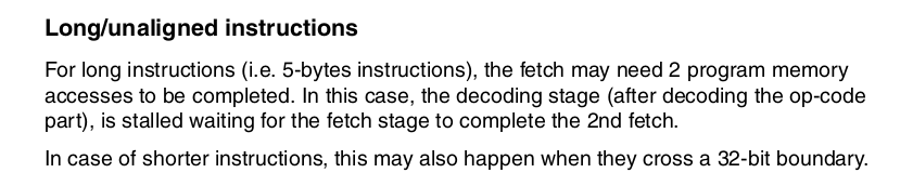

The following snip is from the STM8 programming manual, pg. 22, Doc ID 13590 Rev 3:

I can't post the exact code but I will try to create something representative which will illustrate the behaviour I am seeing. In the mean time though I just want to clarify if there are any alignment requirements for this device. Do misasligned data or function accesses cause stalls in the pipeline or elsewhere in the architecture? Because I have not been able to find anything in the document alluding that it may be the case. Thanks.
2019-04-30 8:51 AM
2019-05-02 7:19 PM
That explains it. Thank you.
