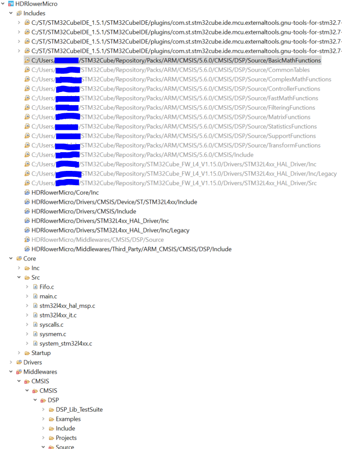

I am importing a project that a colleague made. The project seems to be missing a lot of include files, I know I have the correct libraries in my repository but the project can't seem to find them. It seems like the filepath is pointing to C:/users/colleague/STM32Cube....
but I need to change it to C:/users/myUsername/STM32Cube....
Some of the CDT build console errors:
compilation terminated.
make[1]: *** [Middlewares/CMSIS/CMSIS/DSP/Source/TransformFunctions/subdir.mk:115: Middlewares/CMSIS/CMSIS/DSP/Source/TransformFunctions/arm_bitreversal.o] Error 1
make[1]: *** Waiting for unfinished jobs....
../Middlewares/CMSIS/CMSIS/DSP/Source/TransformFunctions/arm_cfft_f32.c:30:10: fatal error: arm_common_tables.h: No such file or directory
#include "arm_common_tables.h"
../Middlewares/CMSIS/CMSIS/DSP/Source/TransformFunctions/arm_cfft_radix2_init_f32.c:30:10: fatal error: arm_common_tables.h: No such file or directory
../Middlewares/CMSIS/CMSIS/DSP/Source/TransformFunctions/arm_cfft_radix2_init_q31.c:30:10: fatal error: arm_common_tables.h: No such file or directory
compilation terminated.This is a screenshot from my project explorer:
How do I resolve include issues like this?
2021-02-01 5:32 AM
The joy of bad tools..
Probably should consider putting shared projects and repositories in a common directory both can access.
The project file is likely XML/ASCII open in a text editor and search/replace \user\blokeone\ for \user\bloketwo\
2021-02-01 7:06 AM
Ok that seems to have eliminated most of the errors. I'm getting a new one now though:
The filepath is addressing the right user now (me). I think this new error is caused by using a different compiler than the one originally used by the project creator. I tried cleaning and building but no luck.
