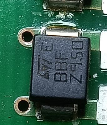

buon giorno a tutti sapreste indicarmi che tipologia di diodo è questo l'unica cosa e che è bidirezionale per il resto non riesco a trovare nessun datascheet

Looks like it's a SMBJ13CA based on the BBF marking. TVS diode.
https://www.st.com/resource/en/datasheet/smbj58ca.pdf

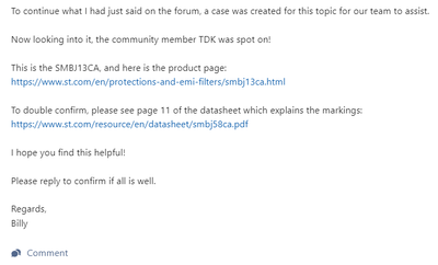

Hi @TDK
No, that is not the case at all! I apologize that you take our responses like that.
We just have a process, and when a forum moderator "flags" a post, it creates an internal Support case for our team. So I (we) just follow the process set in place and answer directly, regardless of what answers before, or after are given.
Here, I will even show you, in this case I both mentioned you and gave you some credit :)
