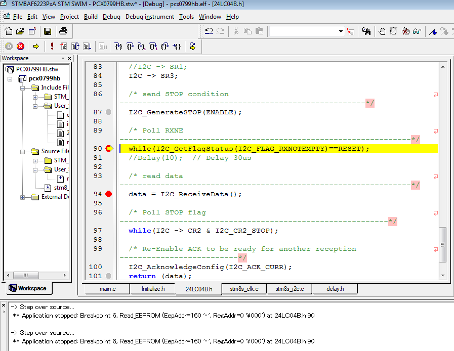

Hi All,
When I use STM8AF6223 read data from eeprom 24C128,I can't poll RXNE flag. This is my code for Read Eeprom:

/* Poll RXNE ----------------------------------------------------------------*/
while(I2C_GetFlagStatus(I2C_FLAG_RXNOTEMPTY)==RESET);
