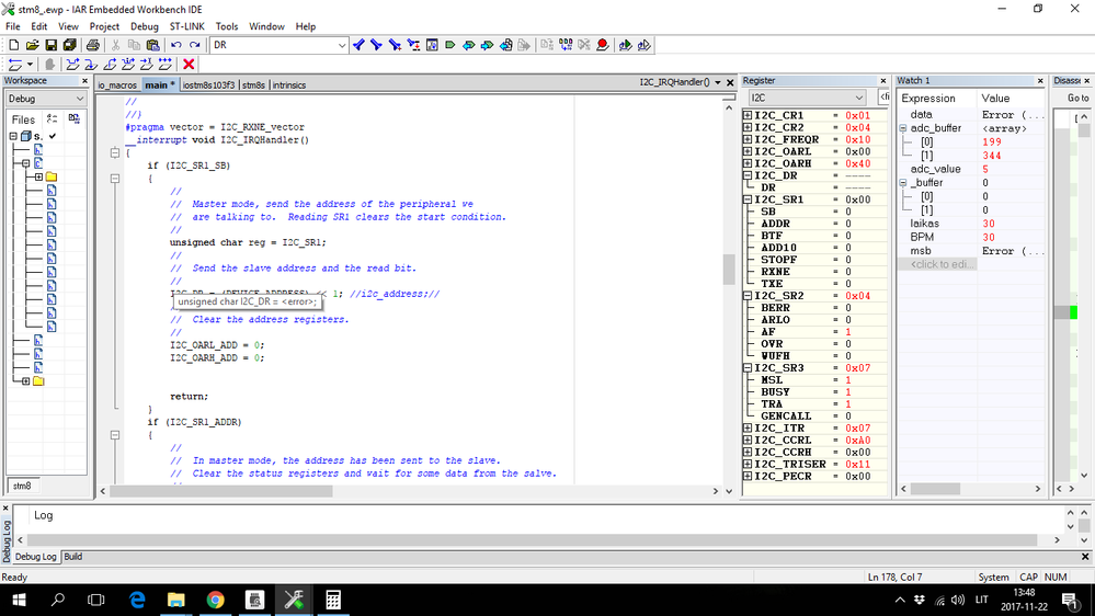

First, somehow DR (data register is not showing anything), I clean ADDR by reading SR1 and SR3, clean TXE by writing DR twice, but can't get any data to buffer from MXL90614 temperature sensor

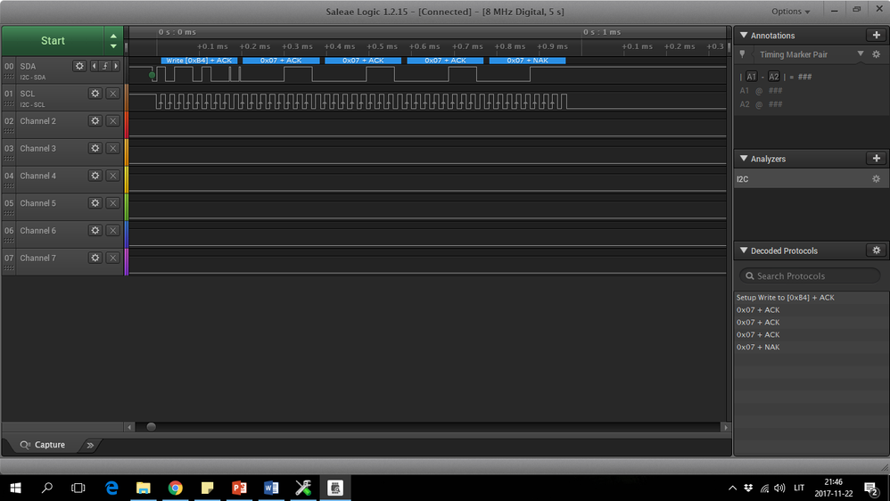

2017-11-22 12:48 PM
Sure.
It send this. Though according to manual I send DR 2times to clear txe. Address of device 0x5A
2017-11-22 1:56 PM
This is a write command because the lowest bit of the address byte (0xB4) is 0. To read, set the lowest bit to 1 (0xB5).
