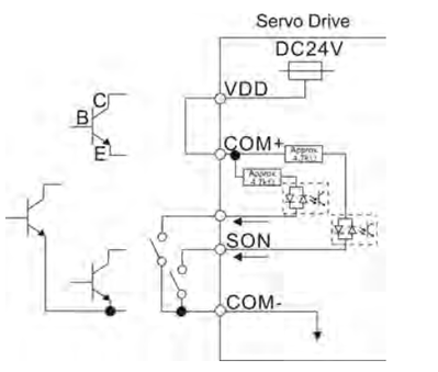

I buy a STM32F411 and on digital inputs I ll conect +24v sensors , on analogic input -10 to 10v sensor , on digital outputs ll go to driver +24v digital input , and analogic output I want deliver -10 +10v for control a motor driver ( I want this signal analogic not pwm wave) frequncy of project is less than 10khz
2024-03-19 11:26 AM
2024-03-19 11:42 AM
on servo driver is 10k ohms for analog
4.7k ohms digital
Im using NPN 24v festo hall sensors
