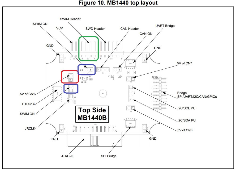

I don't think the user manual is good enough for someone starting with ST MCU's. I have no idea how use the different cables with which boards, etc. Could not find any howto's. I bought this to replace a ST Link v2.
2020-08-01 4:04 PM
The SWIM connector takes a voltage as an INPUT (1.65 V to 5.5 V)
If you need 5V pull it from the jumper location
2020-08-01 7:29 PM
ok used the usb port to power the board and got it to program with STVP
Thanks.
Still think the user manual could use an update with new users of ST MCU's in mind.
