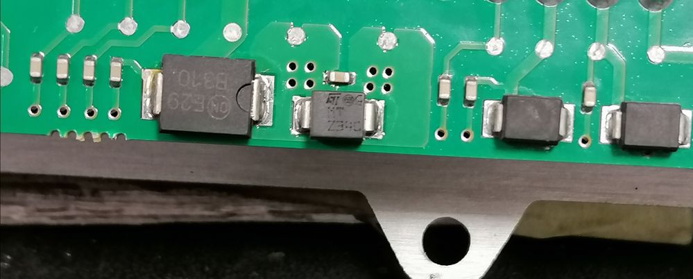

SM6T33CA
2021-01-15 3:11 AM
I would guess a schottky diode.
Perhaps the ST equivalent to the B340A.
2021-01-15 3:54 AM
SM6T33CA
2021-01-15 4:04 AM
I don't think it is a diode because removing the component from the board and measuring it with the multimeter is in diode or ohm mode I have no result. maybe it could be bidirectional, how did you understand that it could be a SM6T33CA?
2021-01-15 4:22 AM
Its listed in the data sheet
2021-01-15 4:43 AM
ok i saw, thanks a lot for the help
