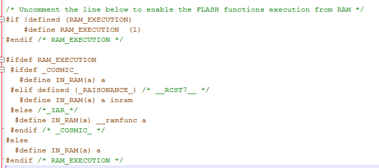

I followed the below steps to execute the Sample code provided by ST.
- For Cosmic Compiler:
1- Uncommented the ''#define RAM_EXECUTION (1)'' line in the stm8s.h file,

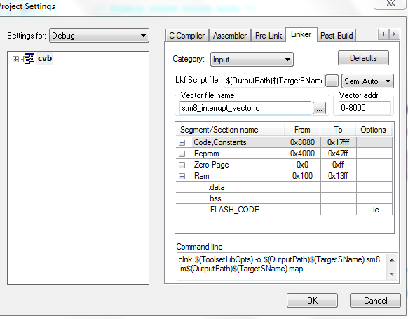

2- In STVD Select Project\Settings\Linker\Category ''input'' and in the RAM section
add the FLASH_CODE segment with ''-ic'' options.
still I am unable to test the FLASH_ProgramBlock(), FLASH_EraseBlock().
By doing the above settings execution is not entering in to
FLASH_EraseBlock(). APIs when I am placing breakpoints.
please let me know any thing I have to set in STVD or Sample Code to edit.
