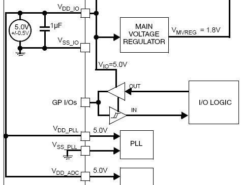

Well, i'm still confused... especially when I look at this scheme 3 :

Hi all,
Well, I haven't seen that the STR75x can operate in Dual Supply with (scheme3). Here attached the confirmation that you can have a minimum I/O output at (VDDIO- 0.8) from STR75x Datasheet : So , Yes it is possible. However, if you have the STR750-EVAL from STMicroelectronics, It seems that the scheme3 is not implemented and you have to rework the board or to design your own board with Scheme3 model to have 5 Volts Outputs. BR, Rave ________________ Attachments : my.JPG : https://st--c.eu10.content.force.com/sfc/dist/version/download/?oid=00Db0000000YtG6&ids=0680X000006HtG5&d=%2Fa%2F0X0000000aKn%2FuLX54vvr4cvPSRiMvS0NHKFnuqW3CT39319cUfIiQak&asPdf=falseWe’re moving the ST Community to a new platform to give you a better and more reliable community experience.
