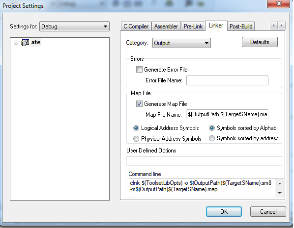

2017-10-13 12:21 AM
in that dialog box there is no option to change map file to hex file?
2017-10-13 12:24 AM
Ho to invoke obsend in stvd settings... Can you please give some example other than in that document.?

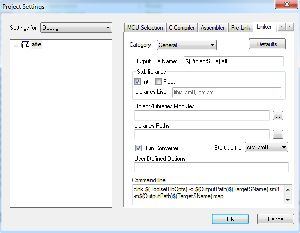

2017-10-13 9:42 AM
Go under Category General, and check other options
2017-10-13 10:05 AM
In general option, what can i do?
2017-10-13 10:18 AM
Dig around a bit, and review available documentation, these aren't my tools..
Cosmic has a CHEX tool for STM8 parts, see if you can use that. Check options for CLNK, add 'User Defined Options' if required. Review other example projects, likely to be at least one that generates .S19 or .HEX files.
