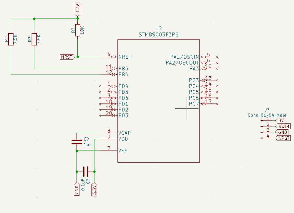

}Below is the circuit diagram
I am using above circuit, I have pulled up PB4 and PB5 as these are open drain pins. I am measuring output from PB4 and PB5 pins and ground.
Can someone help if above setup is correct and if not how to check if PB4 and PB5 are not broken
