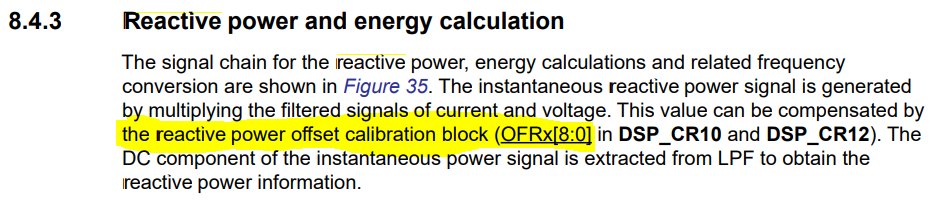

Otherwise, check the value of OFRx[8:0], it might be causing the issue.
