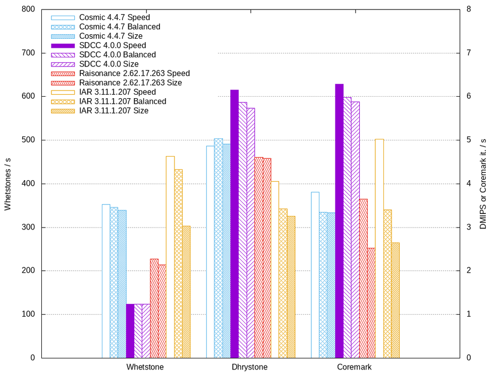

Considering 8-Bit devices, the STM8 is among those with the best tools available. Both considering free and non-free tools:
On the non-free side you have the industry-standard IAR; also Cosmic, which AFAIk integrates well into STVD.
There also is non-free Raisonance, but they have been far behind the other compilers in nearly every way, and haven't even updated their STM8 compiler in years. It still is best when it comes to code size though.
On the free side you have SDCC, a compiler supporting current C standards and generating really good code.
If you want better tool support than the STM8 has, I guess the only option is to got to 32-Bit devices, where there is GCC and LLVM.
A while ago I did a comparison of these four compilers for the STM8:
http://www.colecovision.eu/stm8/compilers.shtml
I intend to update it soon using current versions (already redid the experiments for SDCC and IAR, but still need to look at Cosmic).
Here are some preliminary results in benchmark scores (using current SDCC, IAR and Raisonance, but Cosmic from two years ago):
All compilers have been set to maximum standard compliance and strong optimization. Optimizations goals: Code speed, balanced and code size.
