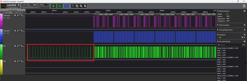

Hi there. I require assistance to ensure the proper operation of GT9271.
After properly RESETting the GT9271, and issuing the 0XBA I2C address, the device keeps pulling the INT pin without any touch on the LCD display (1024x600). I really feel a lack of information, and the datasheet does not give a good description of the registers.
This is my code!

}As you can see, it keeps trigring INT pin withouT any reason.
Please help me to proper configure the GT9721 to my lcd, ER-TFTM101-1.
Thank you!

Perhaps attach the panel data sheet you're working from.
Confirm you're looking at the right pin, and configuring it correctly. Perhaps dump all the registers, check if there's a WHO AM I type register.
Sure you're looking at the touch controller interrupt and not that of the display controller?

Mr. Peter BENSCH Thank you for the tip, but I really HATE Arduino... It is my fault for sure. I refuse to look for an answer in these locations. It seems to me that they don't understand very well what they are doing.
Mr. Tesla DeLorean Thank you! I assure you that the LCD is working pretty fine; absolutely no issues with it. The touch controller has nothing to do with the RA8876 LCD processor, and it is working fine.
GOODIX did not answer, but BUYDISPLAY does. It seems to me that the BUYDISPLAY is a decent supplier, with high-quality products, and they sent me a new initialization sequence that I will test within this week. If it works, I will post here because this may help others to make the GT9271 work fine with the 1024×600 LCD.

Show wiring for YOUR implementation
The GOODIX chip is like a decade old, not entirely surprised the support is lack luster.
Arduino or Linux drivers might be illustrative of initialization or issues. Especially if interrupts need special consideration, and commented about observed behaviour.
