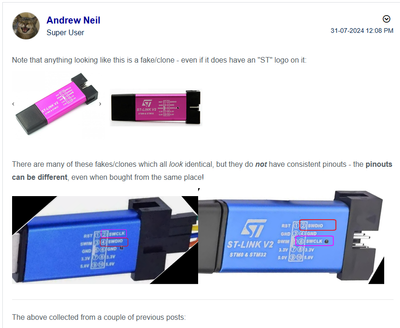

This one? (a post from @Andrew Neil from this knowledge base article:(
If yes, that could be also another problem.
So please use one of the ST boards that contains a genuine chip and STLINK.

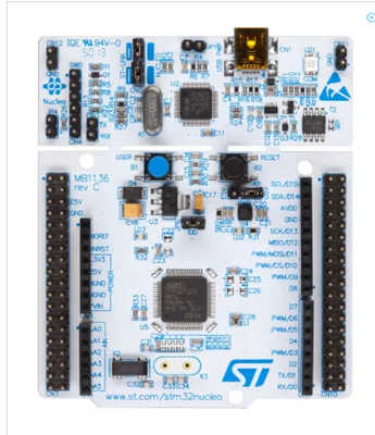

You can purshase: the nucleo board: NUCLEO-F103RB
It contains a STM32F103 genuine chip as well as a genuine ST-LINK:
Hope that helps.

What ST-LINK are you using? as there is a possibility you are using a cloned ST-LINK please read How to recognize a genuine ST-LINK/V2 versus a cloned one
