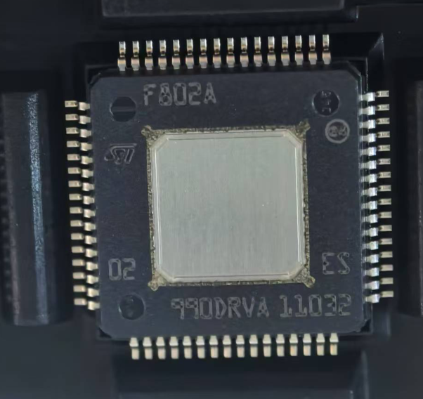

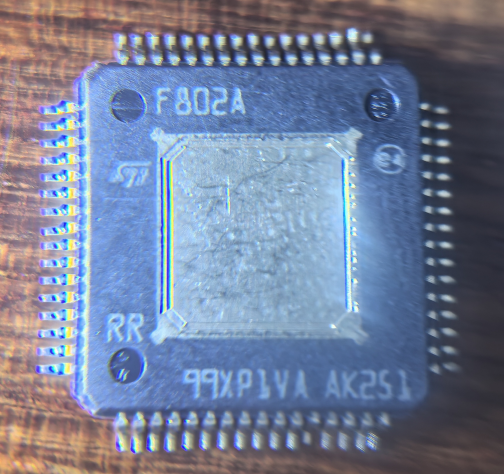

Happy new year.I have a issue for the belows two pictures.Could you pls let me know the meaning of bottom line marking?
"99XPLVA AK251" and "990DRVA 11032"
Since I dealing with a new product design.It's urgent for us.Much appreciated for you support!

Only the last three digits of the line are relevant and show the date code WWY, where WW is the calender week and Y is the last digit of the year of manufacture. The other nine characters in front of it are internal markings.
Hope that helps?

Thank you very much sir.I appreciate your quick reply.So this is the PN what I need,just the different datecode right?
FDA802A-VY

FDA802A-VY is the PN, with a additional Y for tray or a T for T&R appended.
