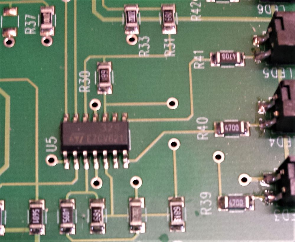

Please, anyone has EZCV621 IC Datasheet?

Hi, RROSS.1,
you accidentally confused the date code with the type number. Your device is the LM324DT, which is available and not obsoleted.

Please include a detailed photo of this device.

Hello, Peter, many thanks for the prompt Answer. this is the Device.

Perfect, many thanks, Peter. I had this doubt that´s an op-amp ( we haven´t unfortunally any Schematic Diagram of the Unit) now i´m shure.
