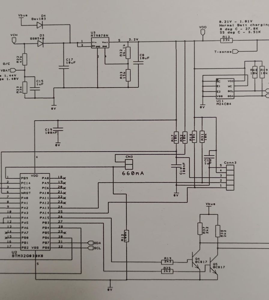

2024-12-03 4:19 AM
this is memory chip connected to the MCU U11 is the memory chip .Can you please tell me the I am using the correct software.I have downloaded EEPRAMA2 which says instance as M24C02 probe
