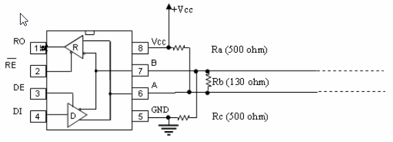

ST485 has an internal failsafe circuit useful when the differential input is floating, which avoids undefined state of the receiver that stays in a stable logic level.
However the internal failsafe resistors are influenced from the external termination loader (54 ÷ 120Ohm) so that an external failsafe circuit is required if the termination resistor is present.
A typical failsafe configuration is shown in figure below. The two resistors Ra (pull-up) and Rc (pull-down) should be 500Ohm while Rb (load) is 130Ohm.
