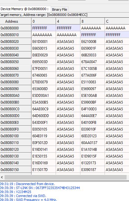

2019-09-03 7:17 AM
So I can see the values change in memory... I changed it so each variable is written as 0xA5A5A5A5.
I verified that it is staying in memory after a reset by changing the code so at startup it doesn't do anything until the user button is pressed, and then connected the St link utility and the values are there OK.
Edit: As I've been continuing to look into it, it looks like sometimes the eeprom memory is erased and doesn't write... not sure what's going on
2019-09-09 1:29 PM
Not sure why it wasn't working before, but everything looks like it is saving ok now.
