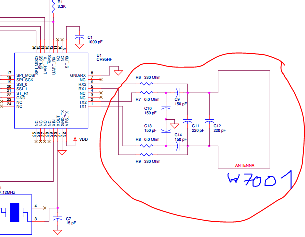

I have a lot of CR95HF for a project that could read NFC Tags of a medical equipment and send this via bluetooth to a smartwatch.I works but i would have now the Pulse W7001 NFC antenna on the CR95HF Chip and we can't get a running system with this antenna.we did not get good results with the calculation tool on the site from the CR95HF chip.https://www.arrow.com/en/products/w7001/pulse-electronics-corporation

as I checked your design and ext. vendor antenna I am expecting the matching issues.
The maximum power transfer between the CR95HF and the load is obtained when the
condition Z
out
= Z
load
is obtained.
Z
load
is the complex conjugate of Z
load
The antenna equivalent impedance an
inductive antenna
does not meet this condition.
The measure of Z
load
gives: Zload = (0.6 + j . 36.6)Ω
To achieve the maximum power transfer between the CR95HF and its inductive antenna,
impedance matching must therefore be performed between Z
out
and Z
load
. It allows to:
Optimize the read range
Transmit the maximum power
Optimize the chip consumption
Maximize the radiated magnetic field
Please read the
AN3394
Application note for
Antenna design and impedance matching guidelines
for CR95HF multiprotocol contactless transceiver IC here:
... in order to check the matching of your design.

I'm using the same schematic as Tom.
I tried to to use the Application Note AN3394 in order to make the matching circuit but without any success to read a tag. My configuration is working fine with a custom antenna made with wound wires but it's not viable.
Is anybody there who find a solution ?
