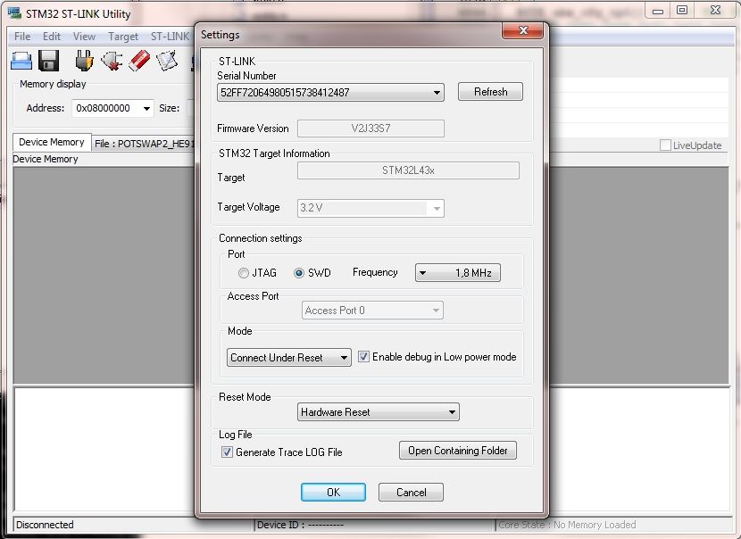

Target->Settings, a Settings window opens:

I haven't that option on the list, i only have Normal and Hot Plug options
2019-05-22 7:58 AM
And i also can't modify the frequency in the port configuration section

It find ST-LINK, version V1, i am using an stm8s discovery demoboard
