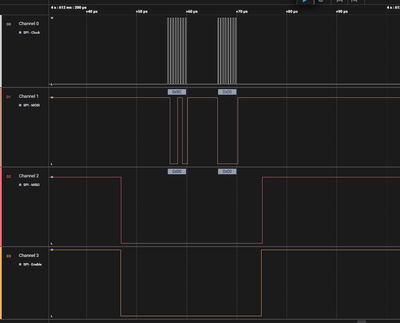

SPI bus log attached
Is that before or after the level shifter?
Show what's actually happening at the sensor's pins.
Have you also looked at the signals on an oscilloscope? Are they clean?

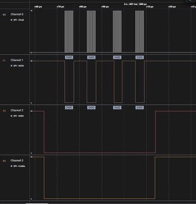

SPI trace attached already from the sensor pins, i have not tried with 3,3MCU voltage since 5 V is operating for this mcu
Above trace is recorded from sensor pins
