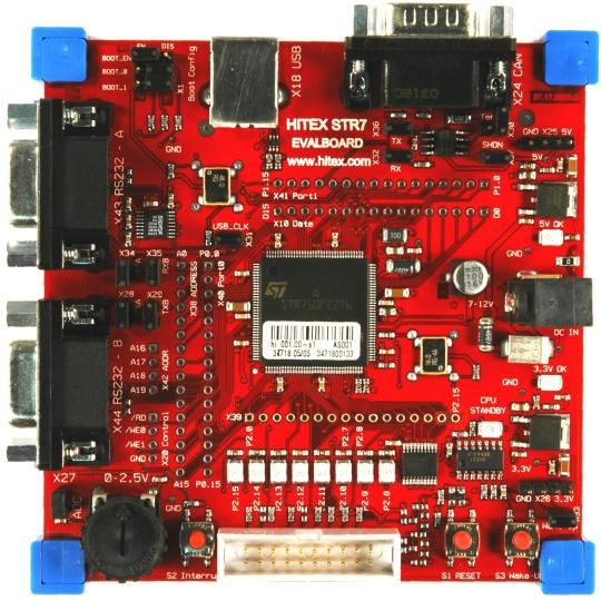

I am working with a STR710FZ2 (on an evaluation kit from Keil, MCBSTR7) and have some problems with the adc resolution. I supply a voltage of 1.5000 volts to adc0 and use a sample frequentie of 1 kHz. When I monitor the adc registers the value varies with 5 counts. (5/4096 * 2.5 = 3,05 mV). since the there is not that much noise on the input signal, I would expect the adc value to be stable. Is there something I can do to get a better resolution?2006-09-19 2:12 AM

after some more research I found that the problem has something to do with the RS232 connection. I have a program which polls parameters via rs232 every 10 msec. When I haven't started the connection everything works fine and I see a noise of about 1 mVolts which is ok.
But after making connection the noise increases on the entire board with about 3 mVolts. so this explains the difference of 5 counts in my adc ((0.003/2,5) * 4096 = 4.9) but I still haven't found the cause of the extra noise. here are the board I'm using and the schematics. If you have any suggestions I would love to here it.http://keil.com/arm/mcbstr7/mcbstr7-schematics.pdf
